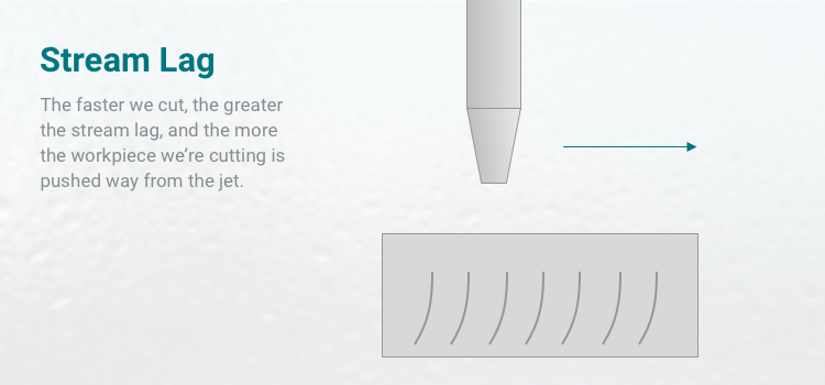

When cutting with water, the waterjet stream will naturally taper from top to bottom of the stream and lag with the movement of the jet.
Tapering occurs when a waterjet loses its power as it cuts through material, creating a V-shaped taper on the object being cut. There are a couple of ways to deal with this.
The traditional way entails slowing down the machine so the jet – and your cut -- remains perfectly vertical. But this isn’t feasible for shops that need to keep their efficiency up. That’s why Flow developed Dynamic Waterjet® to address the issue.
Dynamic Waterjet technology automatically accounts for the known amount of tapering in your cut and compensates accordingly to move any taper to the scrap side of your material, leaving your part with a highly accurate edge. Dynamic Waterjet also automatically eliminates stream lag, compensating for the errors inherent to waterjet, and leaving you with a 2-4x faster cut and the ability to meet and hold high tolerances.
