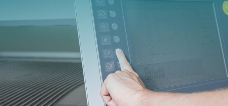

    Hand hovering over the screen/panel of a controller
    The programmer’s job is complete, now the operator takes over. The operator opens the program file in the machine tool controller. The operator clamps the material in place on the work surface of the catcher tank, jogs the cutting head to the position over the material where the waterjet is to begin the cut, turns on the pump, and presses cycle start. This action initiates the program. The water and abrasive turn on and pop through the material, the jet begins to move, cuts the inside circle segments, moves away slightly on what is called a ‘lead out,’ and then the abrasive shuts off, the machine waits a second, the water turns of (this second where the water is on and the abrasive is off gives time to remove all abrasive from the cutting head in preparation of the next on cycle), the jet makes a rapid traverse move to the start point of the outer square, cuts that portion in similar fashion, and the program ends (often with an automatic shut off of the pump and a jog move to get the machine head out of the way for the operator).
